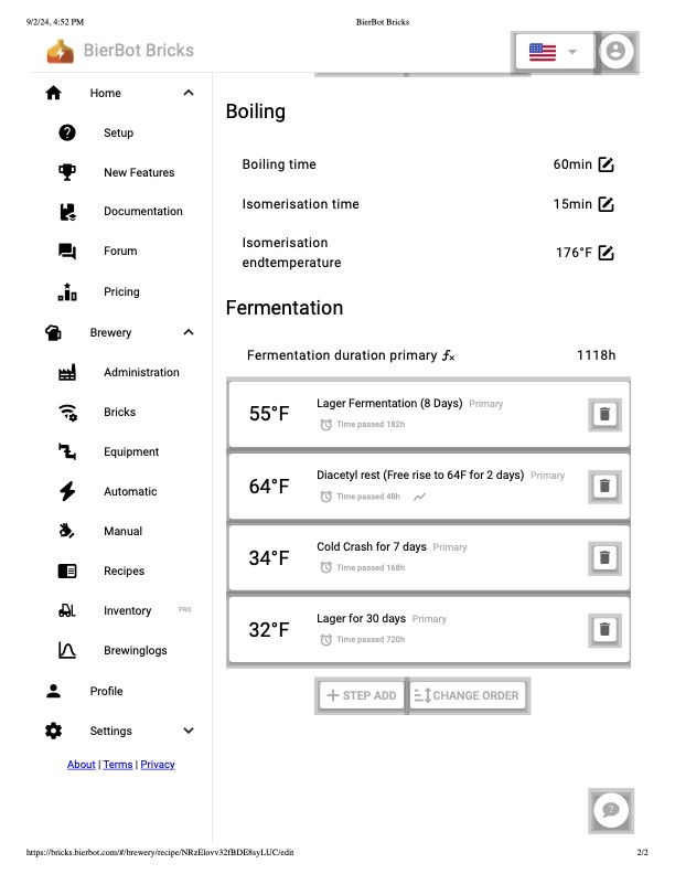

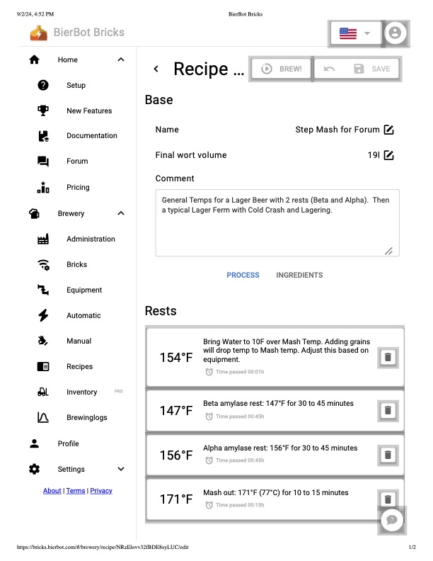

In the meantime, here is an example of a two step lager brew in BierBot with the Mash, Boil, and Fermentation all the way through lager time.
Example Lager Recipe in Bierbot2.jpg (68.13 KiB) Viewed 18400 times
Example Lager Recipe in Bierbot.jpg (76.89 KiB) Viewed 18401 times
