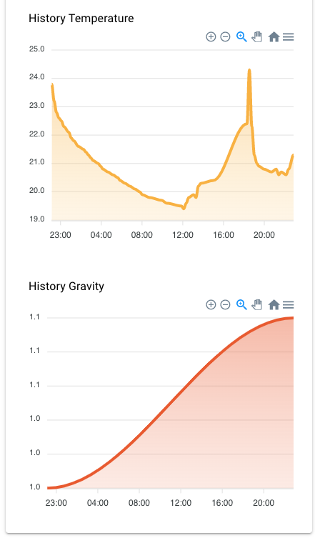

I had to reconfigure it back to Beerfather settings last night as I started a new batch of cider but it looks like when I did, it captured a second gravity value of exactly 1.1 which I'm thinking was the iSpindel horizontal on my desk. (Screenshot attached).
Are you certain you're not rounding SG to one DP?
In Beerfather I have to change the name/SSID of the ispindel to include "[SG]" to tell the software I'm outputting SG not Plato. In Bricks I assume that's all done by the config setting.
I can't enter a manually logged SG value unless it's to one DP. If I try and enter 1.0123 for example and mouseover the value, it says the nearest valid values are 1 and 1.1 and doesn't record it.

- Attachments
- Screenshot 2022-05-07 at 14.35.02.png (50.74 KiB) Viewed 13275 times

so my Pull Request fixing the Bug in the iSpindel was merged on Feb 4th 2022. The latest release 7.1.4. was released Oct 24, 2021. So even if you have the current Release, this does not include the bugfix. I'll reach out to Samuel, when a new release is scheduled.
So two options for you:
- Transmit the gravity in °P to our backend (rounding to 1 decimals won't hurt you)
- Downloading the iSpindel repository and flashing the code instead of the precompiled release 7.1.4. binary.
