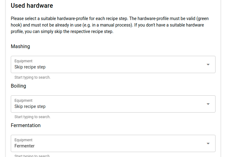

same setup as before, choosing the equipment is unavailable.
I have a fake controller, but it haven't checked in in some time.
only option under fermentation is "skip recipe step"

sorry to hear that. I'm still having issues to replicate your issue:
Fermenter setup
Fermenter is selectable:
Can you ping me on a channel of your choice when the issue is present the next time and "let the issue" be (like not doing anything).
