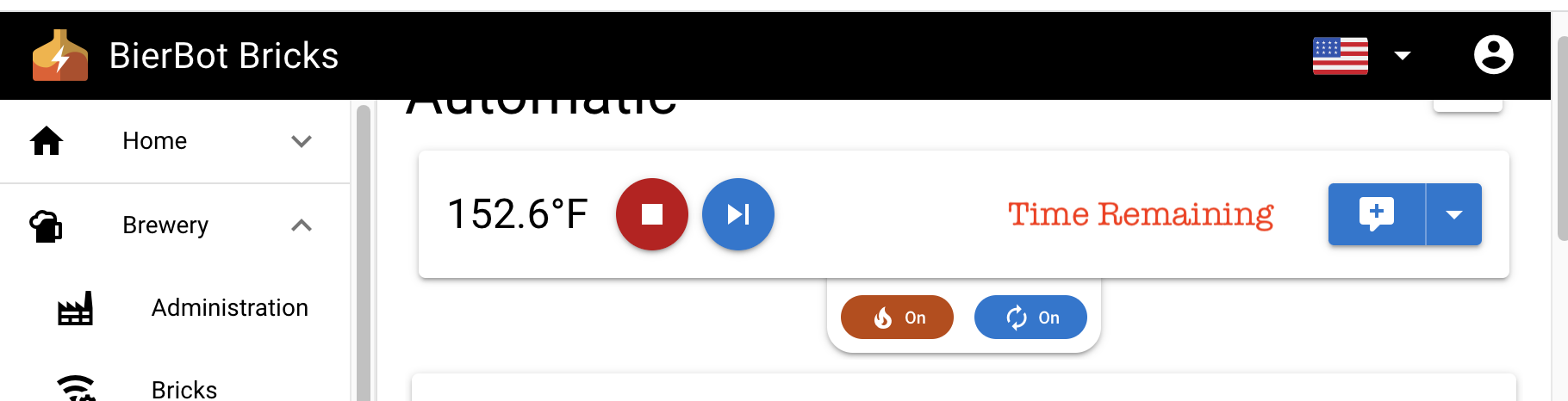

Suggestion: Can the remaining time for the current step be added to the left of the stop/next step buttons? With all the manual steps added the mash and mash out steps are down off the screen on the Pi. It looks like there would be room between those stop/next buttons and button for adding log info.

Regarding your suggestion: You mean on the normal Automatic screen or on the fullscreen, Raspberry Pi screen?

I was thinking something like this. On my laptop this grouping looks the same except it shows the name of the step as well. I assume it is based on available window space. But having the time in this location on all three screens would be ideal when dealing with recipes with a lot of steps.
