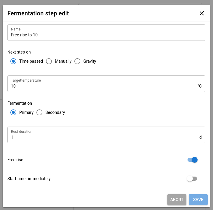

Will be part of next release (latest Sunday this week). Preview is available here.
Heating is forced to be off until temperature of the step was reached. After that, logic is as usual.
The little icon of the rising chart gives it away:
Screenshot from 2024-01-24 18-10-06.png (7.51 KiB) Viewed 12735 times
To activate, toggle in step
Screenshot from 2024-01-24 18-10-25.png (36.16 KiB) Viewed 12735 times
Feedback appreciated!
