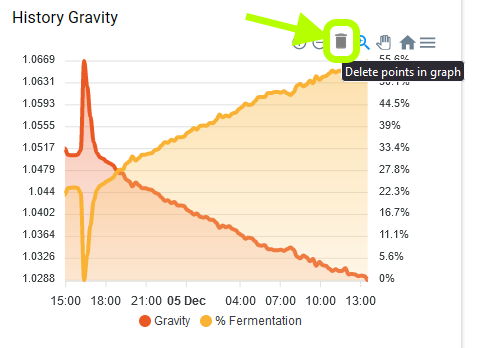

How are the "Delete points in graph" supposed to work?
I cannot figure it out just by clicking around :roll:
I got a couple of values that are just bad data quality ad it messes up the graph :geek:

Hi Flemming,
Thanks for reaching out! I'm delighted someone spotted this rather hidden feature. It's actually made for just that: removing outliers. I can tell you how it's supposed to work.
1. Click on the trash can
2. Click on a point in the brewing log
3. Point should disappear.
If that's not the case for you, please sent me a bugreport and include your API key.

For security reasons, I won't write API keys here, but I can still describe what I'm experiencing:
1: I can delete in the graph of Historical Temperature, but not in the graph of Historical Gravity.
2: It seems like temperature data points are deleted from the beginning of the graph up to the data point I click on - I'm not sure if that's what's happening, but it looks like it.
3: When a data point in Historical Temperature is deleted, I would expect the temporally corresponding data point in Historical Gravity to also be deleted to maintain consistency between the two graphs. It doesn't seem to be happening.
I hope my error explanation can be helpful.

For the bug report, either use the blue button on the lower right side or email us. API key will be displayed when you add a new Brick, but that's only required if you send an email, with the blue button you just need to toggle the "include meta" switch to "on".
What you describe sounds definitely like there is something off. I'll have a look

Hey, brief update: Should be working now :)
