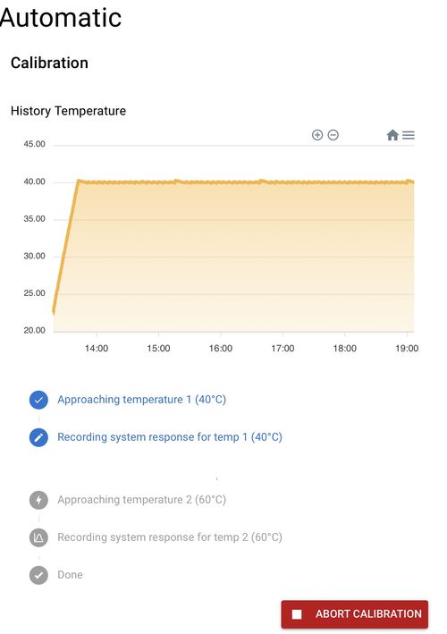

Furthermore, I have tried to do a calibration of my device yesterday and today, with no luck. The test is supposed to take 90 minutes, but after 6 hours, the test is still at 40 degrees C. See attached image.

Regarding your calibartion issue: You've encountered a bug.
The calibration aims to measure overshoots. Currently, for an overshoot measurement (step is called "Recording systems response..." in the UI) to be measured, the temperature has to drop by 0.5°C. Which I think was not the case in your plot (however, I do not have pixel perfect vision :D). I'll tackle that bug in the upcoming release later today/this week by either reducing the 0.5°C to 0.3°C or turning off heating while system response is recorded.

I have now, yet a number of times, tried to calibrate my system, to make it reach the given temperature in a shorter amount of time. The last few degrees takes forever if you are present at the kettle and waiting for it to reach for instance mash in at 65 deg. C.
Feb. 26th I tried a calibration once again.. During the calibration the Raspberry Pi somehow lost its connection to internet, which resulted in an uncontrolled temperature increase. My pumps are only rated at max 85 deg. C, but during the calibration the temperature reached almost 97 degrees C, very close to boiling temperature , before I arrived and unplugged the whole rig. There seem to be no backup system in the event of connection failure.
I would like to be able to set an absolute max value (85 deg C) for the pump to deactivate, to prevent my pumps from being ruined. (This must also work offline). This is also of great value in the case of whirl pooling. When the temperature has lovered to 85 deg. C after boiling, I would like to use the pump for whirlpooling as a part of the «automatic» brew. I can not see that as a possibility today.
Furtermore I have tried a number of times this weekend to calibrate the equipment once again. Yesterday (saturday march 25th) I tried at lest 7 times to start calibration without luck.
The 8th time the calibration started approximately 35-45 minutes after I hit the button. It never managed to get past 40 degrees even after several hours.
The same is the case today. The calibration started at the first attempt, however; but it did not go beyond 40 degrees C after 3,5 hours. 3,3 kW does not make a sufficient difference in temperature of 55 liters in such a small amount of time. To measure my equipment the relay needs to stay on for a longer time to be able to spot the difference in temperature.

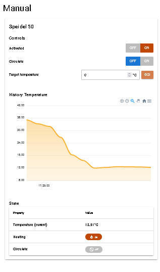

While I was cleaning brushes, lids and other small parts I start to feel a weird smell. The heating elements of the Kettle has been turned on, and they are not quite red in color, but very, very hot as there are no liquid in the kettle.
The target temperature for manual mode is still 0 degrees C, but the heating elements are almost red.
Air temperature is around 12 deg. C and tap water is 6-8 deg. C.
How come the heating elements can turn themselves on, given that target temperature is 0 deg C? Fortunately I was only 5-8 meters away from the kettle, but this could have resulted in another outcome eventually.
Please see picture. The heating elements has been turned on at 12 deg. C shortly after the kettle has been emptied.

ivarole wrote: Sun Mar 26, 2023 10:05 pm Furtermore I have tried a number of times this weekend to calibrate the equipment once again
Sorry to hear that. We are currently experiencing issues with brews starting slower than expected. I'm trying to resolve it ASAP.
ivarole wrote: Sun Mar 26, 2023 10:05 pm How come the heating elements can turn themselves on, given that target temperature is 0 deg C? Fortunately I was only 5-8 meters away from the kettle, but this could have resulted in another outcome eventually.
Can you send me an E-Mail with your API-key and exact date and time (best case precise to the minute) - happy to take a look. Only explanation for the Screenshot: There was no request from your RPi (the heating batch reflects the last state)

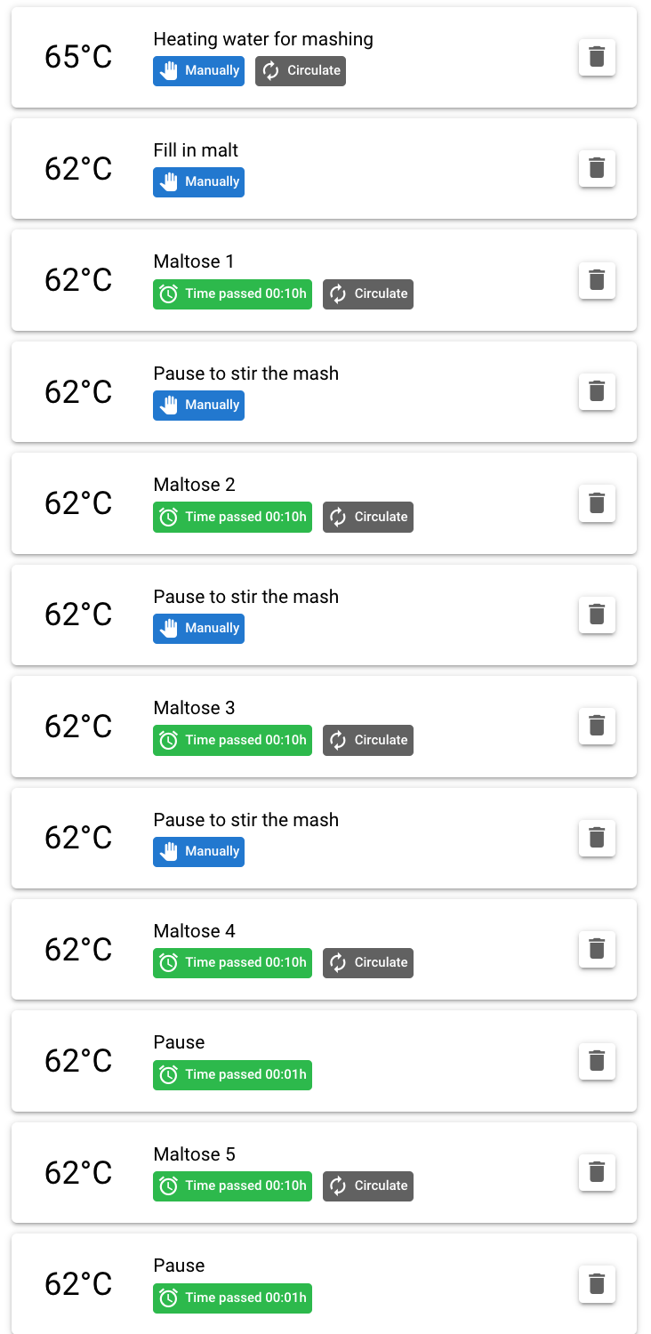

During automatic mode there is a button to skip forward to the next step. It would be really nice to also have a "previous" button, to go back to the previous step.
During my last brew I created 27 mashing steps, due to the need for stirring in the mash at the very start, and pause the pump to loosen the malt during the rest of the mashing. This is a RIMS system, which is circulating the wort from below the grain bed. I guess there are a limited number of brewers using this particular system. Here are the first few steps...
