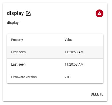

JoDaNl
Posts: 23
Joined: Wed Mar 01, 2023 10:49 am
Re: Brew/Fermentation temperature versus used Brick
Post by JoDaNl »
Yes I did. Sorry, fogot to mention that.
See picture below
Screenshot 2023-10-14 125003.jpg (15.36 KiB) Viewed 100031 times
Regards,
Jos
Hmm. Can you send me your API key via email? Happy to take a look.
Cheers
