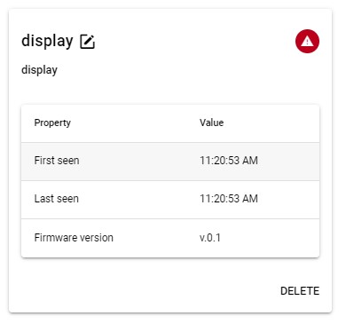

Re: Brew/Fermentation temperature versus used Brick
Posted: Sat Oct 14, 2023 10:51 am
by JoDaNl
Yes I did. Sorry, fogot to mention that.
See picture below
Screenshot 2023-10-14 125003.jpg (15.36 KiB) Viewed 100051 times
Regards,
Jos
Posted: Sat Oct 14, 2023 4:44 pm
Hmm. Can you send me your API key via email? Happy to take a look.
Cheers
