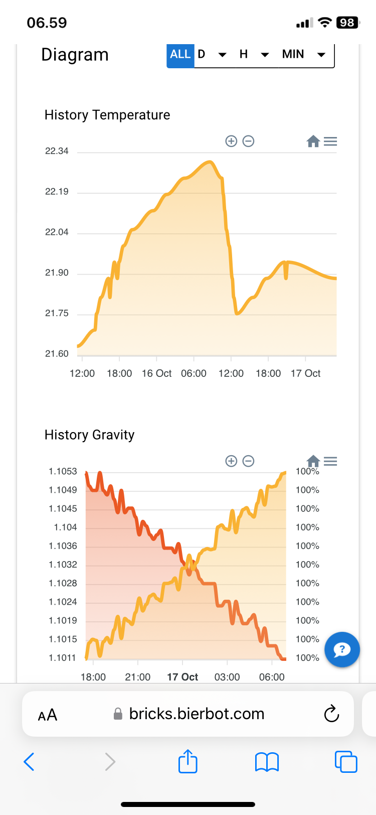

The values in the screenshots cannot be trusted. I have juggled so much around with the settings, i pure desperation, that most of them are unreliablel.
My iSpindle is calibrated - using high sugar solution and diluting it slowly while recording tilt angle to get the correct calibartion values into the iSpndle Firmware.
Like I mentioned in first post - Everything WORKED flawlesly for my FIRST brew... now - a few weeks later - gravity is not recorded and no graph is showing.
I suspect it have something to do with recipy maybe... and/or relation between https://bricks.bierbot.com/#/settings/interface and https://bricks.bierbot.com/#/brewery/bricks Settings . . .
I have also tried to use "Overwrite polynom to calculate gravity" using values from ducumentation(I know they do not fit 100%) just for test but it do not change that no datapoints are recorded in gravity history graph.

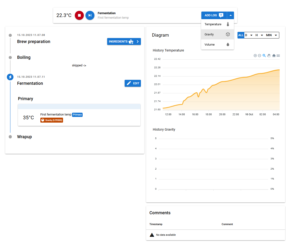

I just found that i can not enter gravity in log manually either?
This is really puzzleing me :lol:
ScreenShot 2023-10-16 082455.png (76.41 KiB) Viewed 37116 times
The popup shows up and i can input numbers and click Add - then a short animation shows up briefly but no datapoint is added anywhere as far as I can see... :?:
