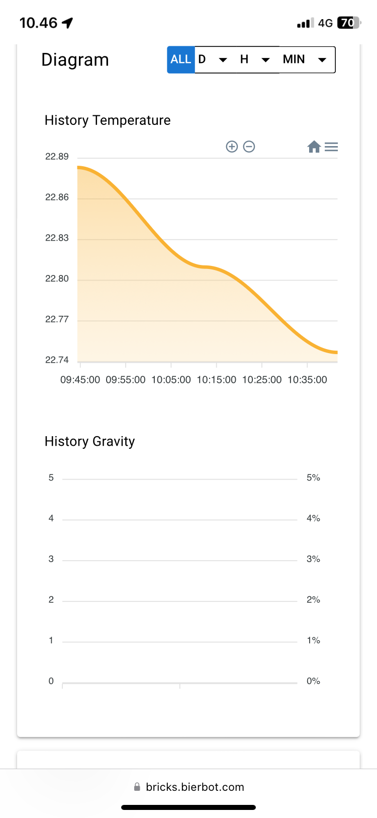

I started experience problems like metioned in subject.
The first fermentation recorded fine. But now something have changed and i can not figure out what :?:
Temperature from iSpindle is recorded fine but not a single gravity datapoint shows up

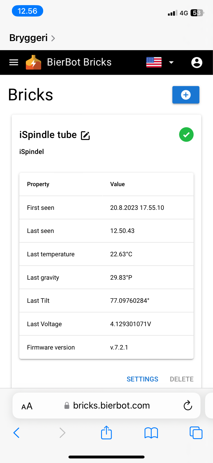

Re: iSpindle does not record historic gravity
Invalid values are automatically filtered out. I currently don't have my laptop with me, but I'm pretty sure 29°P is considered invalid.
Calibrating the angle to gravity values should fix it.

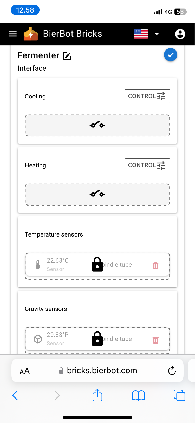

The values in the screenshots cannot be trusted. I have juggled so much around with the settings, i pure desperation, that most of them are unreliablel.
My iSpindle is calibrated - using high sugar solution and diluting it slowly while recording tilt angle to get the correct calibartion values into the iSpndle Firmware.
Like I mentioned in first post - Everything WORKED flawlesly for my FIRST brew... now - a few weeks later - gravity is not recorded and no graph is showing.
I suspect it have something to do with recipy maybe... and/or relation between https://bricks.bierbot.com/#/settings/interface and https://bricks.bierbot.com/#/brewery/bricks Settings . . .
I have also tried to use "Overwrite polynom to calculate gravity" using values from ducumentation(I know they do not fit 100%) just for test but it do not change that no datapoints are recorded in gravity history graph.

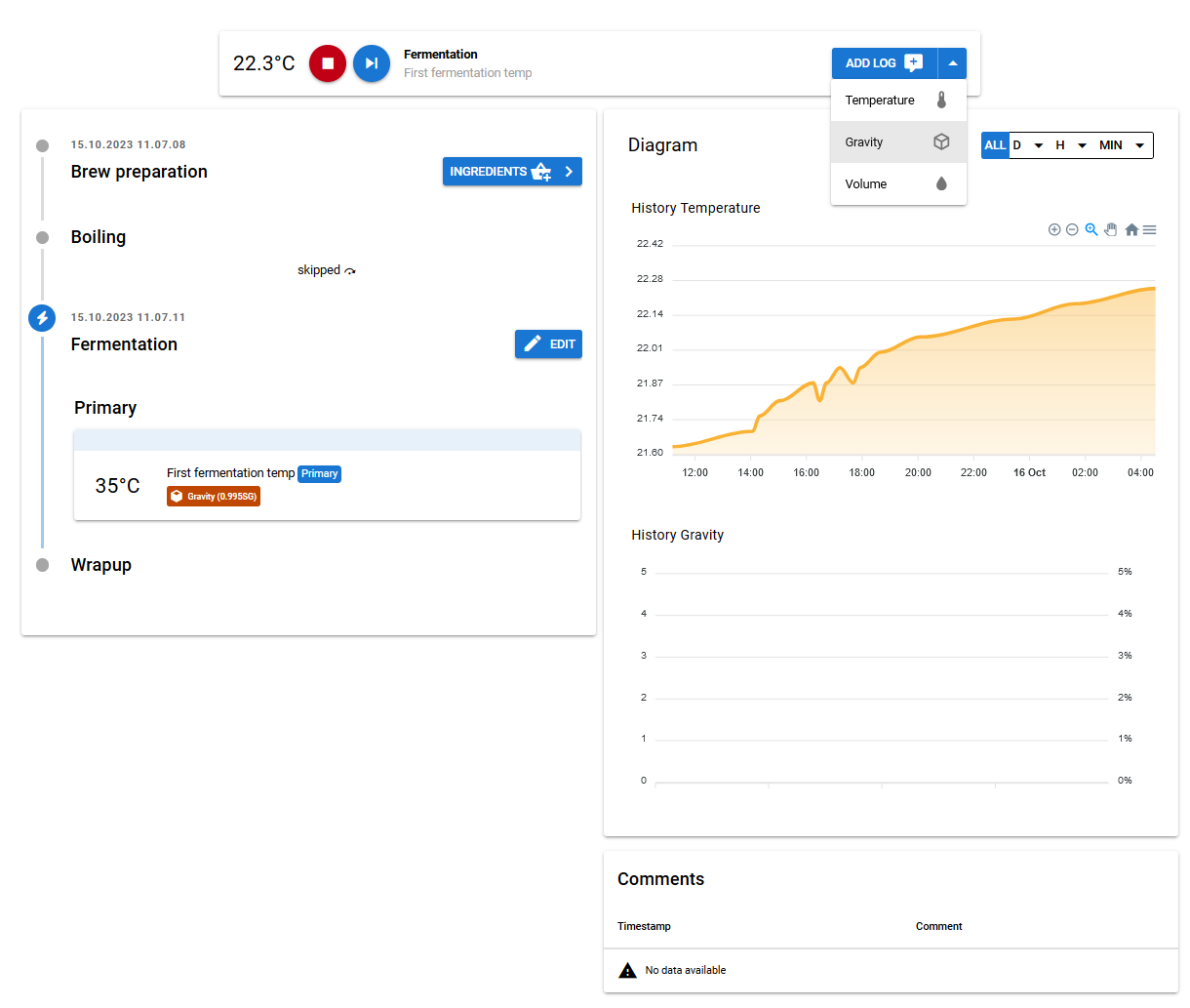

I just found that i can not enter gravity in log manually either?
This is really puzzleing me :lol:
ScreenShot 2023-10-16 082455.png (76.41 KiB) Viewed 37111 times
The popup shows up and i can input numbers and click Add - then a short animation shows up briefly but no datapoint is added anywhere as far as I can see... :?:

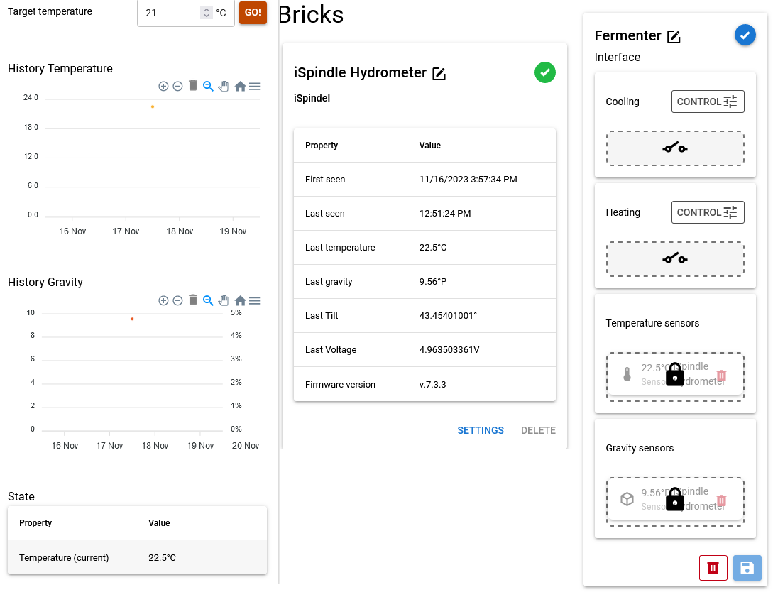

Have the same problem with my new ispindel, all parameters are in normal limits, readings a stable evry 15min, no historycal graphics, just a point of curent temp and gravity in "manual" mode.
