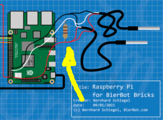

I've tried 3 different probes and none appear when I try to set up my biab profile. Gpio inside is enabled on my pi. Ordered another probe just to be sure. Any ideas?
Re: Ds18b20
Hey Diggerg,
sorry to hear that! A few ideas:
- Check if you have the resistor (4.7kOhm) connected between 3.3V and Data (usually white)
- Check that you connected it to the right GPIO (GPIO 4)
- Same goes for 3.3V and GND. Maybe try other 3.3V or GND GPIOs.
- It should be covered by the steps in the tutorial, but you activate w1 explicitly (that's the protocol that's used to read out temperatures) like i.e. described here.
- Make absolutely sure, that the connections are snug. This is crucial (and I fucked this up many times).

Yeah still no luck. I'll wait till my new probe turns up and try again. Used both 3.3v outputs and different grounds but no reading

Another idea: connect them to the 5V instead of 3.3V (in theory the DS18B20 supports a range from 3-5.5V)

hmmm, really strange. There seems to be one systematic thing ...
Let's do it the other way round can you share:
- An image of your raspberry Pi settings screen for switching on/off peripherals?
- An image of your Raspberry Pi and the connected GPIOS
- The content of your config file (bricks.yaml)
Anything else where you think it might be important?
